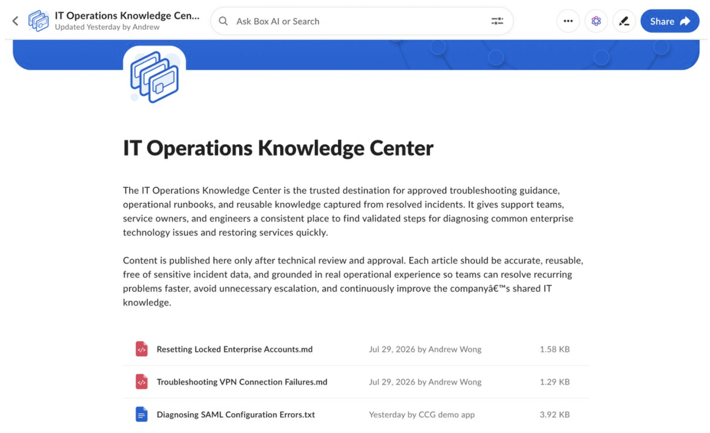

The approved articles are connected to a Box Hub, which acts as the trusted knowledge collection.
img 01
The IT Operations Knowledge Center Hub, containing the approved articles used by the workflow.

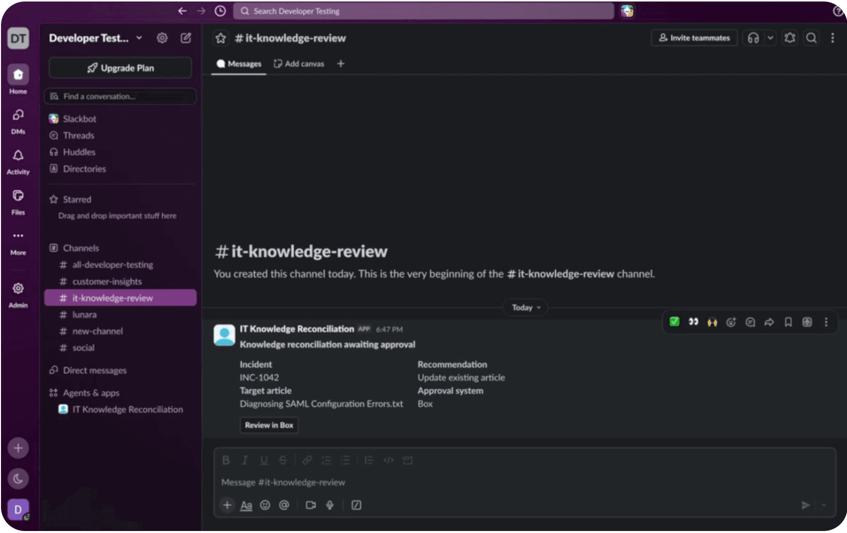

Slack can send the reviewer a link, but it’s optional. If Slack isn’t configured, the app logs the same notification and Box review URL to the console.
Approval always happens in Box. Slack is just there to get someone’s attention.

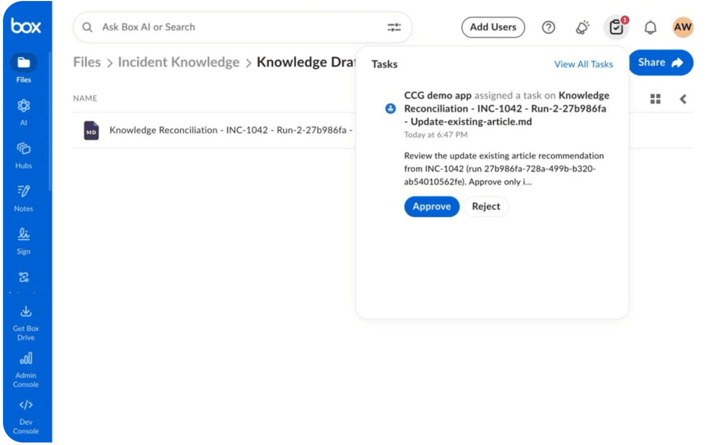

That file goes into the Knowledge Drafts folder, and the app creates a Box review task for the configured reviewer.
const task = await box.createReviewTask({
    fileId: draftFileId,
    message: `Review the recommendation from ${incidentId} ` +
        `(run ${runId}).`,
    completionRule: "all_assignees",
await box.assignTask({
    taskId: task.id,
    reviewerUserId,
This is where I wanted the AI portion of the workflow to stop.
The AI can extract information, compare it with existing content, and prepare a strong first draft. In this workflow, it deliberately does not publish shared operational guidance on its own.
That feels like the right tradeoff for this use case. Reviewing a focused proposal with citations is much easier than rereading the full incident report, but a person still decides whether the recommendation is correct and safe to reuse.

Slack is optional
Slack is useful for sending a reviewer a link, but I didn’t want it to be required just to run the demo.
03
At startup, the app chooses between two notifier implementations:
const notifier =
    token && channelId ?
    new SlackNotifier({
        token,
        channelId
    new ConsoleSlackNotifier({
        logger
The workflow calls the same methods either way:
await notifier.postProposal(...);
await notifier.postResult(...);
Without Slack credentials, the console implementation prints a clearly labeled mock notification containing the Box review URL.
This keeps Slack-specific checks out of the main workflow. The app always has a notifier; configuration determines whether that notifier talks to Slack or the terminal.
