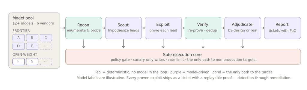

Every path to a target in our engine runs through a single policy-gated execution core that’s rate-limited, with every write scoped to a disposable canary object which the tool itself created, then restricted to non-production environments. Production is strictly read-only; writes and autonomous agents are restricted at the gate. It’s not just a rule in a runbook;it’s the only code path that exists. The scope lives in the architecture, not in the prompt, because a prompt is a request and an architecture is a constraint.

Inside the boundary: the pipeline
Your initial instinct may be to take one strong model and scale it out to multiple parallel agents. Resist it. Blind spots correlate inside a model family, so multiple agents with identical instincts can walk past the same flaw and report high confidence doing it. Coverage looks like a compute problem, but it’s actually a diversity problem. We run more than a dozen models across six vendors, which turns one model's opinion of your surface into a matrix. Diversity buys precision and coverage: a hypothesis raised independently by models from two different vendors gets corroborated and sorted first. The model pool is what the reasoning stages draw on. The recon and verification stages are deliberately model-free. The pipeline itself is six stages, and the five that touch the target reach it only through the boundary:
02

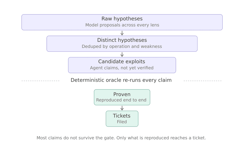

  1. Deterministic recon runs before any model does. We map the full callable surface, documented or not, and fire the cheap probes at all of it. This is mechanical work that needs no reasoning. Agents get those results as their starting input. It's the same as handing a pentester the recon instead of asking them to start cold.
  2. Scouting agents read the source, not just the API. White-box agentic testing beats black-box, and it isn't close. When a scout can read the authorization path and the middleware around it, its output stops being a guess about behavior and becomes a claim about implementation. You already trust these models with your code in your IDE; trusting them in your test harness isn’t a new decision.
  3. Exploit agents prove the hypotheses. When a model proposes a claim, its exploit isn’t taken as proof. A deterministic oracle that shares none of the model's incentives has to reproduce it end to end, and a separate skeptical model, never the proposer, tries to refute it. A model grading its own hypothesis grades generously, so we don't let a model be the judge at all.
  4. Verification is deterministic and can throw the AI's work away. A finding is only proven when a non-AI oracle independently reproduces the exploit end to end, and that same oracle re-runs each confirmed proof several times and drops anything that passed only once — a lucky or cached response never ships. This is also where false positives die: a claim the oracle can't reproduce is demoted to a labeled lead, duplicate reports of one bug collapse into a single finding, and a claimed information leak only counts if a normal, benign request doesn't produce the same error. Otherwise the agent has found how the application always behaves, not a flaw. Everything that fails to reproduce is queued for a new oracle or a human red-teamer. Demoted, never silently dropped.
  5. A reproduced exploit still isn’t automatically a bug. Sometimes the behavior is intended, and only someone who knows the system would catch it. So before a proven finding ships, a panel of separate models re-checks it against three things: our own design docs, the source (including the upstream services the API gateway delegates to, where the real authorization often lives), and a fresh live probe. A finding is set aside as by-design only when all of them agree, with evidence, and none defends it as a real break; a split or uncertain verdict leaves it in the report. The pattern this catches: a tenant can mint an invitation that looks like a cross-tenant write, right up until you notice that the actual control is that only the receiving tenant’s admin can accept it. Proof gets you past, “is it reproducible?” This gets you past, “Is it actually wrong?”
03
  1. Reporting ships remediation, not detection. Every proven finding carries the affected operation, source path, severity, reliability, weakness mapping, an exploitation scenario, a proposed fix with blast radius, and the replayable proof of concept. No re-scan, no re-triage, no argument about whether it was ever really exploitable.

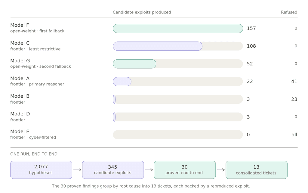

The best model overall wasn't the best model for this
In one run, our top-producing model surfaced roughly seven times the validated leads of the frontier model holding the primary reasoner role. It wasn’t the most expensive model in the pool, or the one that wins coding benchmarks. It was an open-weight model.
The spread was also enormous and unpredictable from the outside: the top contributor produced roughly fifty times the validated findings of the weakest and one model, blocked by its provider's filter, produced none at all. Rank order had almost nothing to do with published benchmark position or price per token. If you're selecting the model behind your security tooling on general capability score, you're selecting on a proxy that doesn't hold here. The only way to know is to measure on your own surface.
Where guardrails trip, an open-weight model picks up the work
Several frontier providers apply real-time filters that decline offensive security work. In our runs, that included authorized, owner-initiated testing against our own non-production systems. One model in the pool returned zero findings for that reason — not because it lacked the capability, but because it wouldn't accept the task.
Those filters are a reasonable product decision. A hosted provider can't verify that the person asking it to find an authorization bypass owns the system in question, and the consequence of getting this judgement wrong is severe. The filters aren't the problem.
The problem is how the refusals surface. A declined unit of work doesn't throw an error. Nothing crashes, the run completes, and unless you're watching for it, the only trace is an absence. A result that produced nothing looks identical to a result that found nothing.
So we don't let the hypothesis die at the model refusal. Every declined unit is detected, logged, and re-dispatched to an open-weight model running under terms that permit authorized security testing. The work changes hands rather than disappearing, and the refusal itself gets surfaced in run health alongside verification downgrades and blockers, so we can see the rate and trend.
In our runs, the open-weight backstop did more than we expected. In a single run, 64 exploit attempts were refused on policy grounds. Together with timeouts and other errors, 89 were recovered by the backstop chain; the same mechanism catches work that fails for any reason, not just refusals. Without somewhere for that work to go, those hypotheses are gone, but the report would still come back looking complete.

What we changed: frontier for depth, open-weight for breadth
Model benchmark ranking didn't predict results, and no single model would have given us the breadth and depth of coverage we gained through our multi-model approach. The two tiers of models earn their place in different roles.
Frontier models earn their place on depth. When an agent holds one specific theory and needs to chain three conditions to prove it, they're noticeably stronger, and better at reading unfamiliar code and reasoning about an unfamiliar weakness. We don’t hard-assign them to a stage; every model scouts every risk lens. But the hardest multi-step chains are where a frontier model most often makes the difference.
Open-weight models cover the breadth. They produced the bulk of our validated leads at a fraction of the cost, which matters when your scout stage is proposing thousands of hypotheses. And they didn’t stop at breadth; the single highest-yield model at the exploit stage was open-weight too. They also come under terms that don't prohibit authorized security testing, so the work simply runs. Nothing decides mid-run whether your authorized test of your own system looks acceptable.
