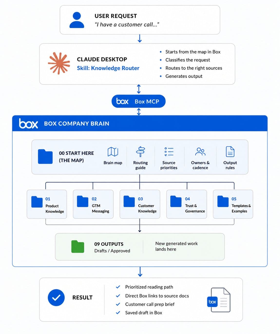

01
Architecture diagram showing User Request → Claude Skill → Box MCP → Box Company Brain → Source Docs → Draft Output

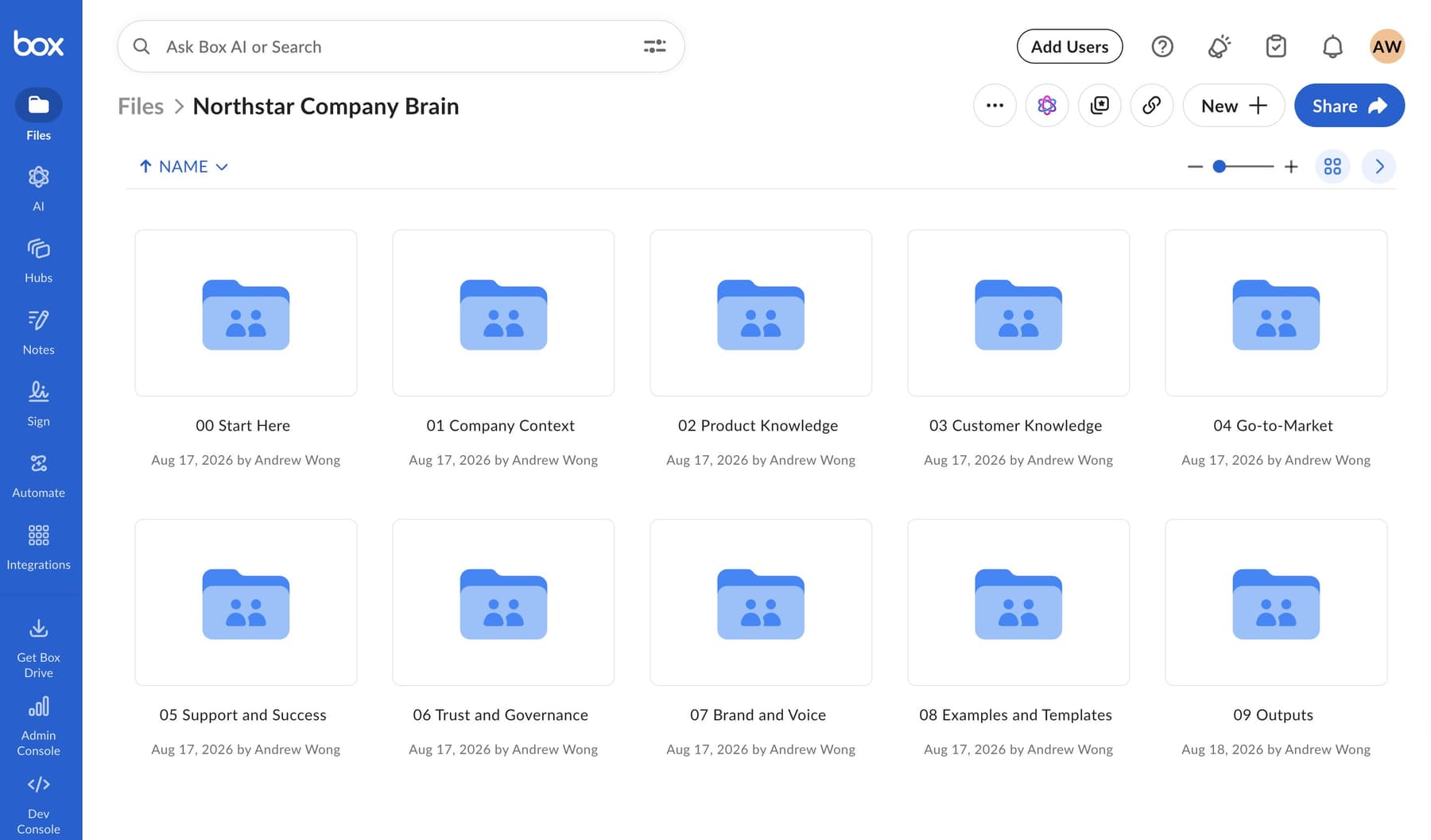

02
Box UI showing the Northstar Company Brain folder and 00 Start Here
The Skill starts there. It reads the map, classifies the request, and then follows the routing logic to the right files.
That separation is the whole point. If the knowledge base changes, I update the files in Box. I don’t need to keep rewriting the Skill.

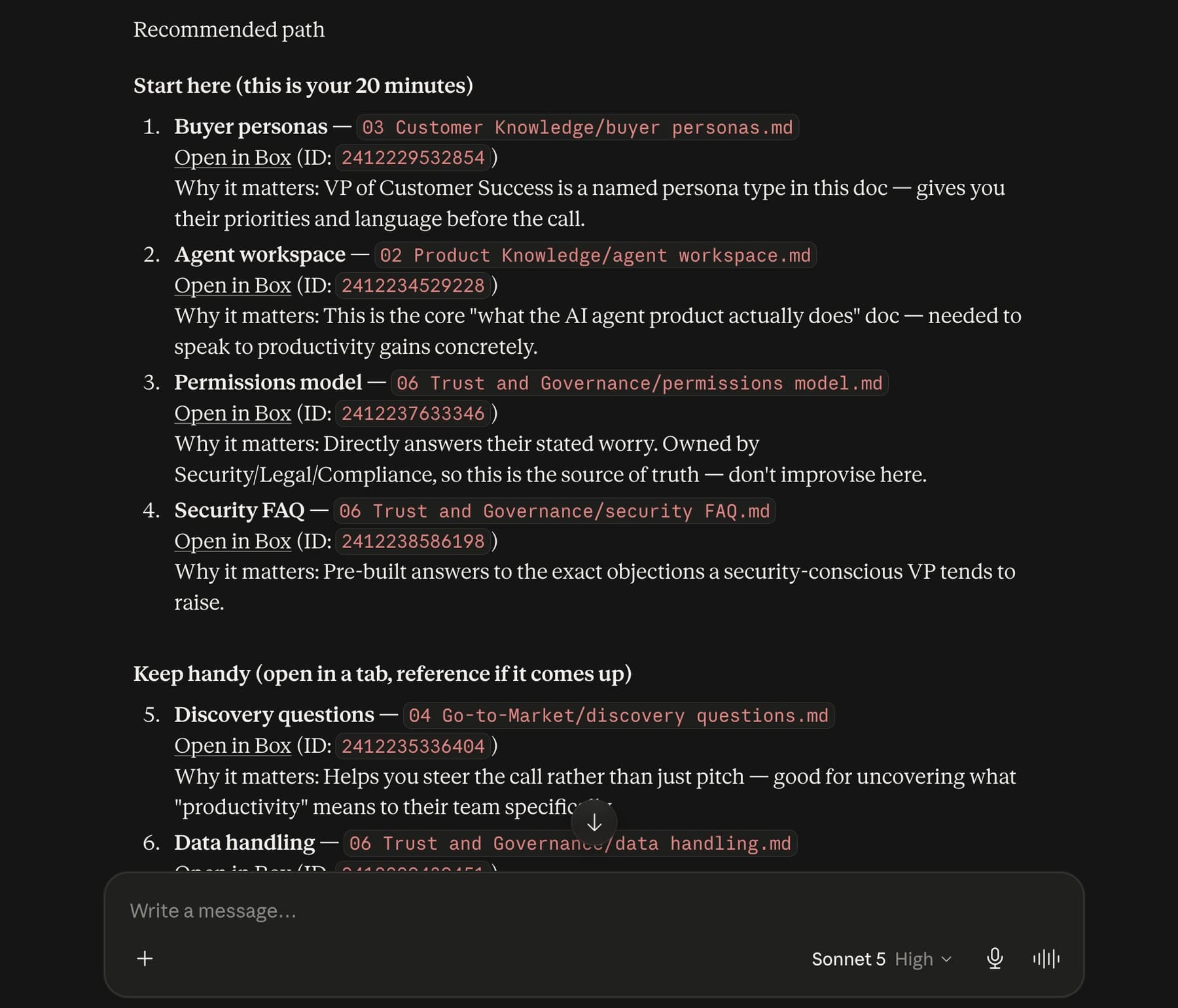

Prompt one: find the right sources
The first prompt in the demo is a normal work request:
Use the Knowledge Router.
I’m preparing for a customer call tomorrow with a VP of Customer Success
who wants to understand our AI agent product.
They care about improving team productivity, but they’re worried about
permissions and data security.
I only have 20 minutes to prep — what should I read first?
I like this prompt because it does not tell Claude which folders to search. It just describes the situation.
The Skill routes the request across the right parts of the company brain: customer context, product knowledge, GTM messaging, and trust guidance. Then it gives me a short reading path with direct Box links.
3
Claude response showing grouped recommendations with Box links
That link detail matters. I don’t want the agent to say “go read the permissions model” and make me dig for it. I want to click straight into the source file.

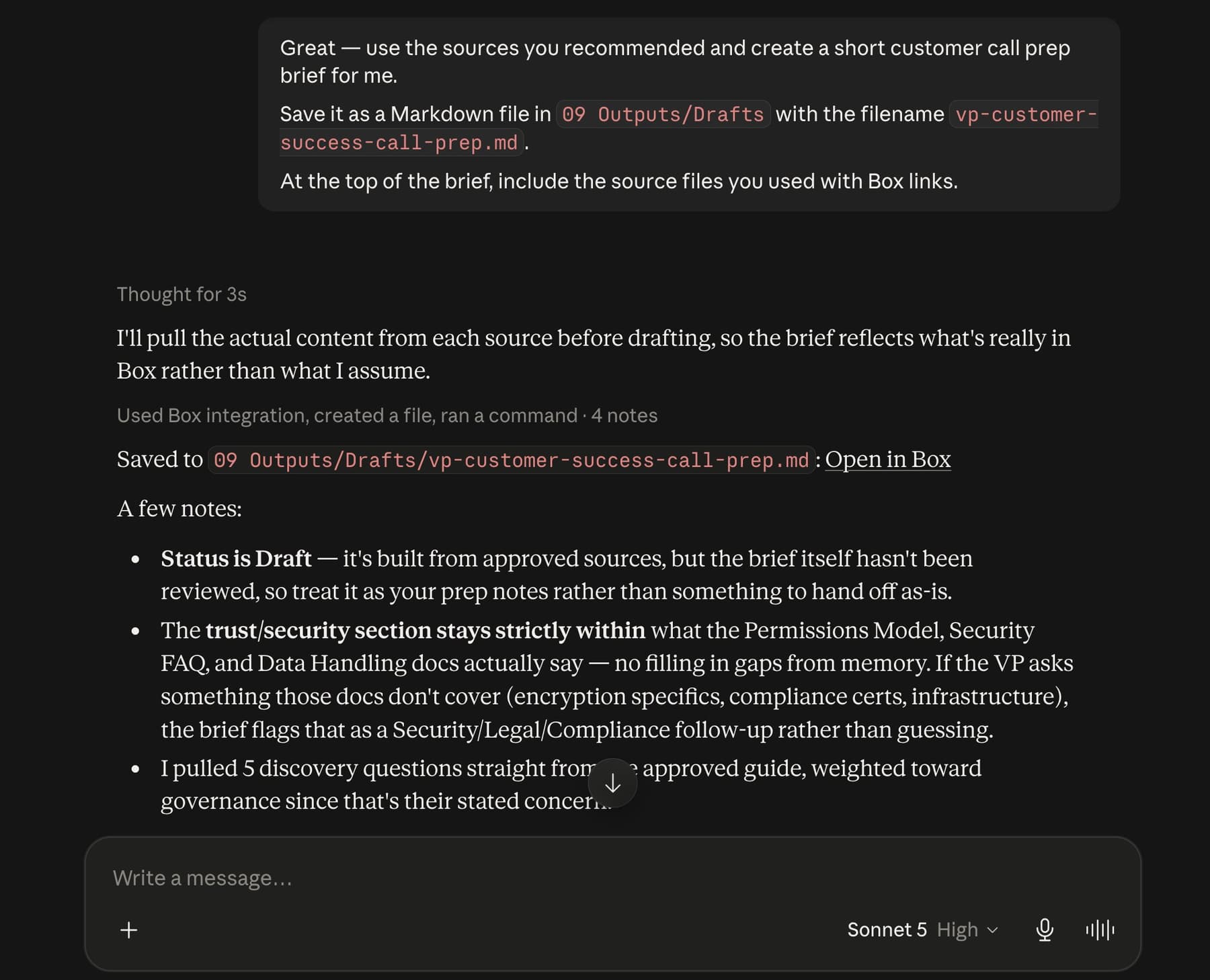

Prompt two: create the brief
After Claude finds the right sources, I give it a follow-up:
Great — use the sources you recommended and create a short customer call
prep brief for me.
Save it as a Markdown file in `09 Outputs/Drafts` with the filename
`vp-customer-success-call-prep.md`.
At the top of the brief, include the source files you used with Box links.
This is my favorite part of the demo.
Claude uses the source docs, drafts a customer call prep brief, includes the source links at the top, and saves the file back into Box under 09 Outputs/Drafts.

That means the output is not trapped in the chat. It lands in the shared workspace, where someone else can review it, edit it, move it forward, or reuse it later.
I also like saving it to Drafts. The agent created something useful, but that does not make it approved guidance. Drafts is the right place for generated work until a person reviews it.
The Skill makes that explicit:
If asked to save the draft, save it under the appropriate folder in
`09 Outputs`, usually `09 Outputs/Drafts`.
Do not save to `09 Outputs/Approved` unless the user explicitly says
the content has been reviewed and approved.
